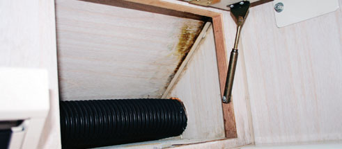

The leak was coming through at the rear left corner wall of the pop-top, and water was leaking through at a fair rate. The first job was to raise the roof so we could see if there was any sealant missing on the join around the roof and its base. Everything seemed okay, so we decided the easiest thing to do was remove the side moulding to inspect for leaks.

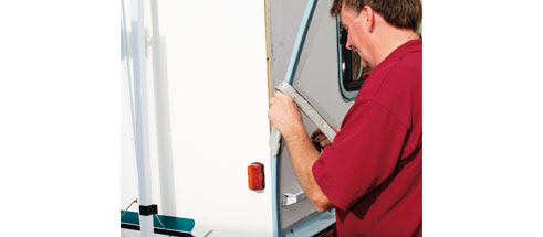

Once we had removed the screws holding the side moulding, it was then a matter of carefully peeling away the moulding. Using a scraper to gently pry it away from the body helped because the aluminium is easy to bend out of shape.

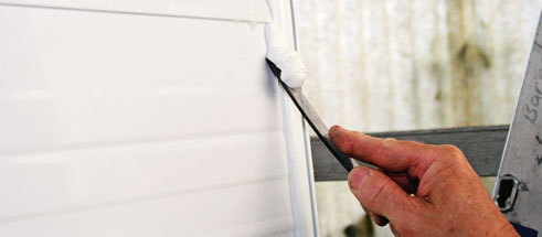

This sealant lasts an hour before going off and you have to allow time for clean-up, so we made sure we had everything close to hand. We placed the moulding onto the back of the van and started screwing it into place. With all screws in we attacked the clean-up, first coating the area with a liberal spray of soapy water. We then began lifting off the excess sealant with a plastic scraper (ours was actually a custom Perspex job). Don’t use a metal scraper here because you’ll find it hard not to mark the paint.

1 It’s clear the leak had been coming through the cupboard for a while.

3 Carefully peel away the moulding.

13 A plastic scraper lifts excess without scratching the painted surface.
