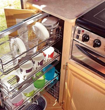

John’s work in the kitchen improves storage space and allows more options when preparing food, important in a pop-top where every square millimetre is precious. Where possible, all internal lights have been changed out with LEDs. Another light was added above the sink and one in the rangehood. Two new taps now live next to the sink; one for the van’s water tank and another for town water when it’s connected.
The drain pipe took up an awkward amount of space under the sink, so John re-routed a new pipe to the rear of the locker where it can’t interfere. There’s also a filter to clean onboard water.

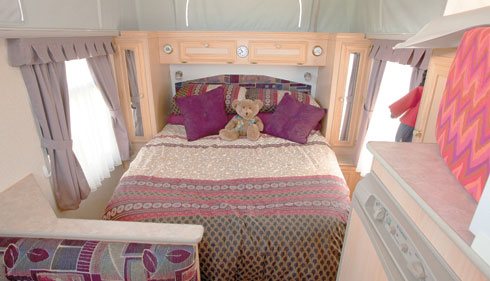

You don’t want to get up too early, so a small brass clock was installed in the headboard, along with a barometer and humidity gauge.

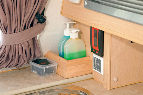

The neat little frame stows washing-up liquid. Wireless gauges (to the right) indicates the temperature of the fridge and water level.

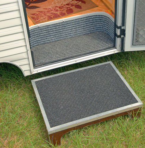

An extra step makes entry and exit that little bit safer.

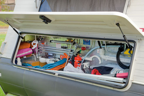

Everything in its place. The boot has been rigged to carry tools and every maintenance item a vanner would likely use on a daily basis. The gas cylinder is also in there, on a custom-made bracket, while clips of one sort or another support everything else.

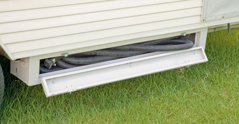

The nearside aluminium box in front of the axle holds drainage pipes.
